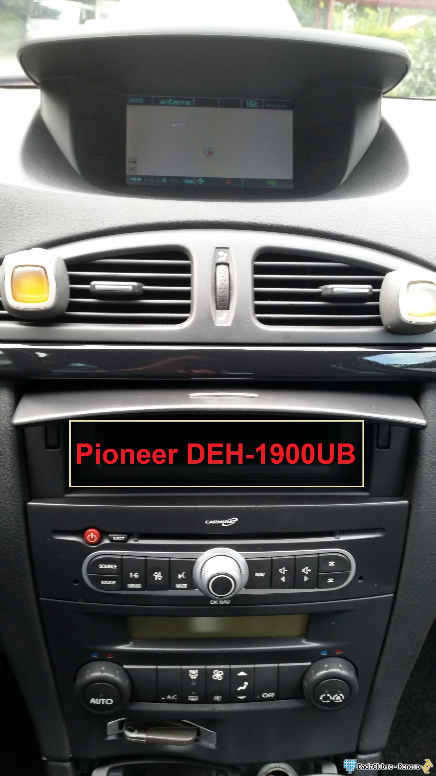

I'm looking for help to ENABLE AUX on the CNI2 Radio.
I have a Megane 2 / 2007 with a Carminat Radio + Navigation + CDC
I want to keep the CDC and enable AUX. Is this possible ??
If so what do I need to buy, and which pins do I need to connect?
This is the radio + cdc:
http://i57.tinypic.com/r9n05s.jpg (image trop grande)
http://i62.tinypic.com/zxwd91.jpg (image trop grande)
thank you!
